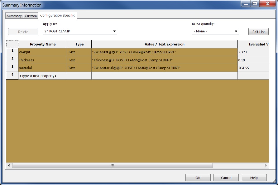

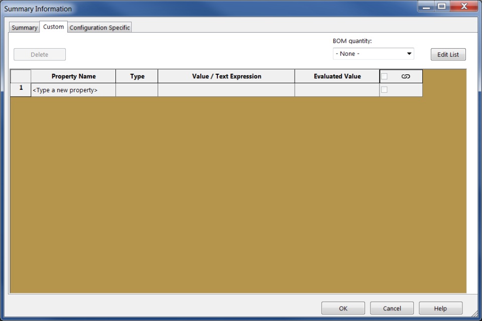

I have a macro that I cannot seem to get to function properly.
What I want is for the macro to choose values from the Configuration Specific menu in the Properties Manager but instead it is taking values from the Custom menu. How can I get the macro to choose the Config Specific menu?
Macro is pulling values from here
I want the macro to pull values from here.
this is the macro

*** this is the section that needs to change
'Get Custom Property
Set swCustPrpMgr = swModel.Extension.CustomPropertyManager("")
swCustPrpMgr.Get3 "Thickness", False, "", Value
swCustPrpMgr.Get3 "Material", False, "", MTRL
