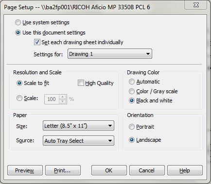

I'm trying a macro for page setup options.I tried a recorded macro. It works fine for the follwing three settings.
Scale to fit
Paper size
Orientation
For unknown reasons, two settings ('High Quality'  & 'Drawing Color' ) in the page setup are not working even after running the macro
High Quality checkbox should not have a tick mark & drawing color to be "Black & White. - "THIS IS MY REQUIREMENT"
Code is below, Could anyone please help !
Also please see the image of page setup dialog box in the att
