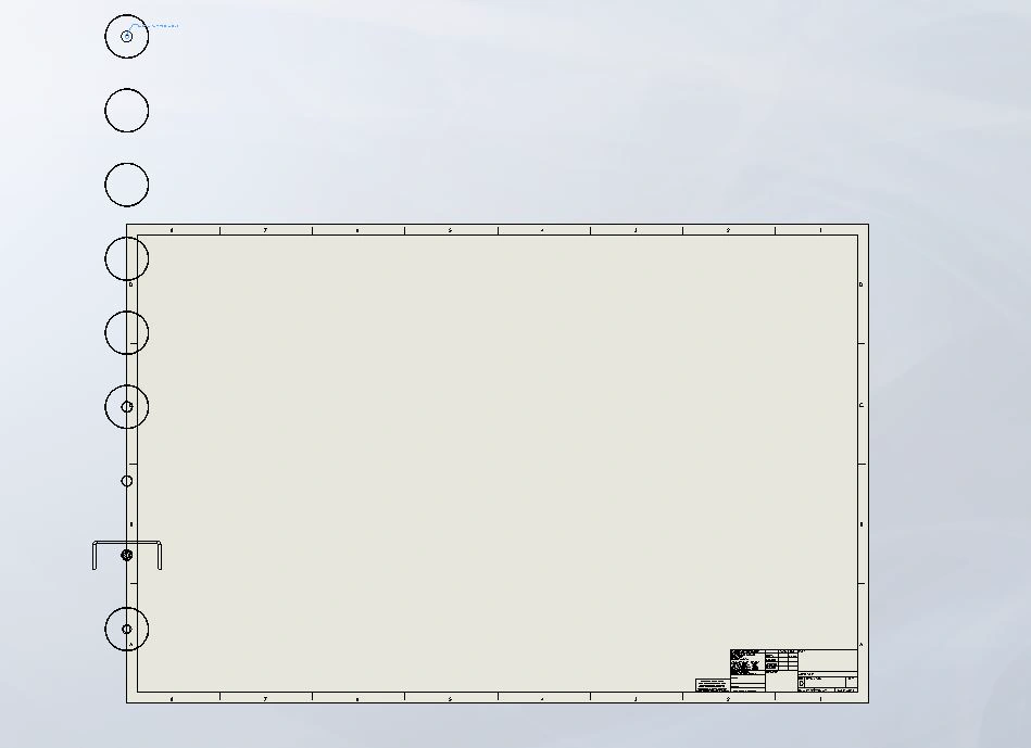

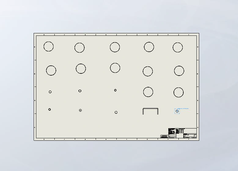

Hello everyone,
I'm trying to write a macro that organizes my drawing views on a single sheet. Essentially, I have 20-40 views on a sheet but when I add them they are randomly placed. So I'm trying to create a macro that will look at my sheet size, look at the view sizes, and move them into rows and columns to create a cleaner sheet. I have a macro halfway built but for some reason it only stacks my parts vertically. If anyone can help, I'd really appreciate it! Attached are a few images, one shows what the code gives me and the other shows roughly what I'm hoping to accomplish. Thanks again! Here is the code,
