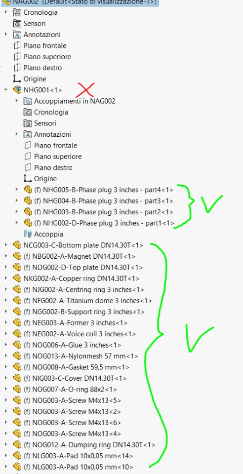

I found on this forum the following macro from ​ ​and I modified it with my custom properties.
My problem is that, when I have a sub-assembly I am not able to change the component name of the sub-assembly.
As you can see in the following image all the parts, also the sub-assembliy parts, have been renamed (code-revision-description) but the sub-assembly remains with the original file name (code).
Is there a way to modify the macro?
Thanks in advance.

DK 2017-06-30 Best Answer
Hello Riccardo,
as far i can see, in your macro there is only one decision making IF statement with "Part only" case, try this one, I've attached case, when doc type= assembly:

       ElseIf swChildModel.GetType = swDocASSEMBLY Then
       swChildComp.Select2 False, 0
        'Get configuration name
        swCompConfig = swChildComp.ReferencedConfiguration
        ' Get Configuration Properties Values
        Codice = swChildModel.CustomInfo2(swCompConfig, "CODICE")
        Descrizione = swChildModel.CustomInfo2(swCompConfig, "DESCRIZIONE")
        Revisione = swChildModel.CustomInfo2(swCompConfig, "REVISIONE")
        NewName = Codice + "-" + Revisione + "-" + Descrizione
        swChildComp.Name2 = NewName
        Debug.Print swChildComp.Name2
         End If

DG
DG 2017-07-01
, just comment out these two lines and you should be good
comment imagecomment image
