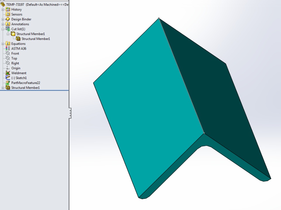

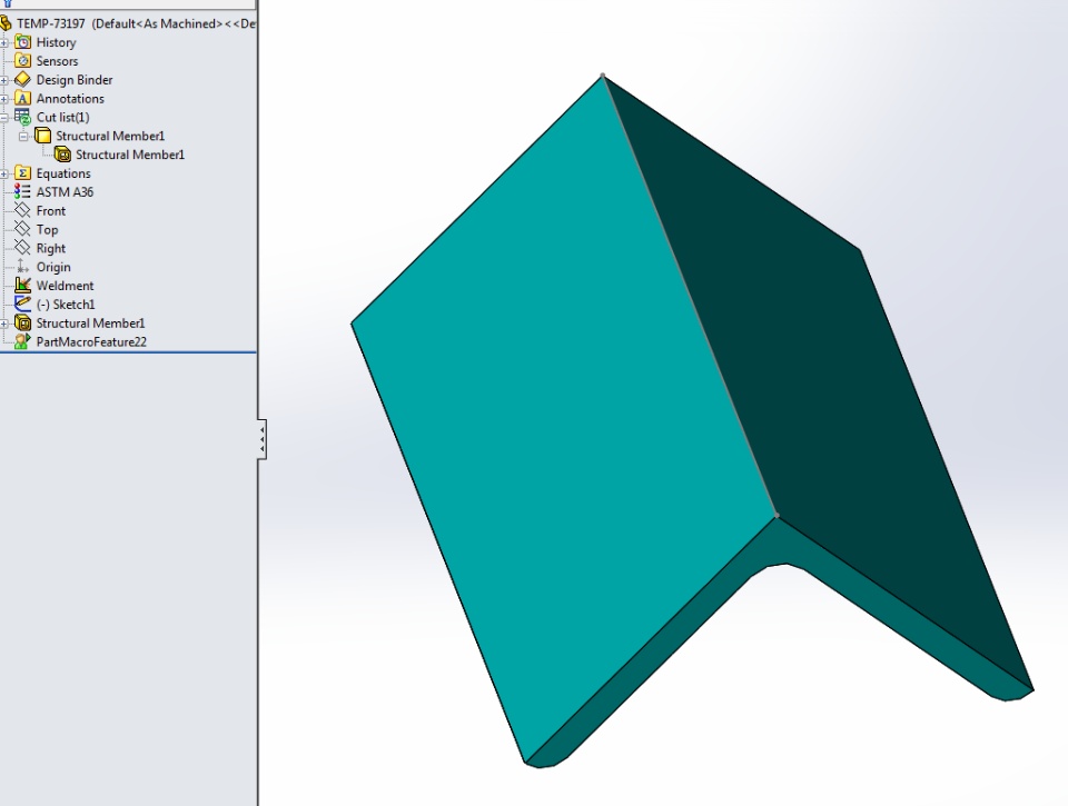

So when the macro feature is located here, rebuilding this
Results in creating a cut list item, or this:

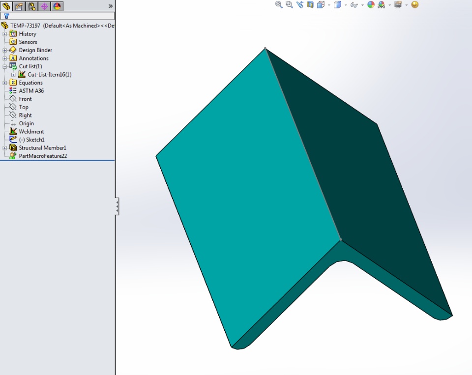

Rebuilding the below results in no change to the cutlist folder.
