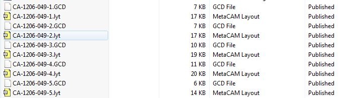

We are implementing ePDM shortly and would like to save all of our machine programs into the vault.  We are receiving an error from software "Cadem, NCnet-Lite" it says file does not exist.  We can browse and file is there, and program works fine from our old directory.
Any suggestions.

JF 2012-06-15 Best Answer
make sure you have a local copy of the file. just because you see the file name in windows explorer does not mean you actually have a copy locally. highlight hte file name and "get latest"
