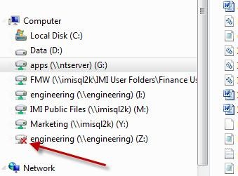

We also sometimes see mapped network locations with a red X in Windows Explorer on our Windows 7 workstations (see attachement).  When we select a drive with a red X, the connection to the server seems fine.  Could that be related?
There are no network-related error messages showing up in the event logs of the workstations.  We also checked the switch to see if anything strange was going on with any of the ports.  We even switched around some connections to see it was a bad switch port but that didn't make a difference.

We have exactly the same problem on our first workstation with a similar environment (network, server 2003, Seven x64, and SW 2010 SP0.0)
But (on this network) with our second workstation (XP32 and SW 2010 SP0.0) we have no problem
Our SW vendor says to us that it comes due to the fact that we are in "workgroup" and not in "domain"
and also to open "DNS" !!!

I determined this issue occurs when we use Windows XP Mode to run our legacy 2D CAD program. We have now resorted back to using Windows XP as our main operating system. Any feedback out there from experience with Windows XP Mode?
