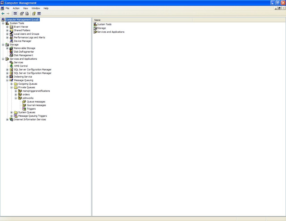

The MSMQ queue itself is setup using Control Panel, Administrative Tools, Computer Management. From here drill down into Services and Applications/Message Queuing. (see the attached image) Right click on the Private Queues folder, New/Private Queue and give the queue a name. Thats it.
