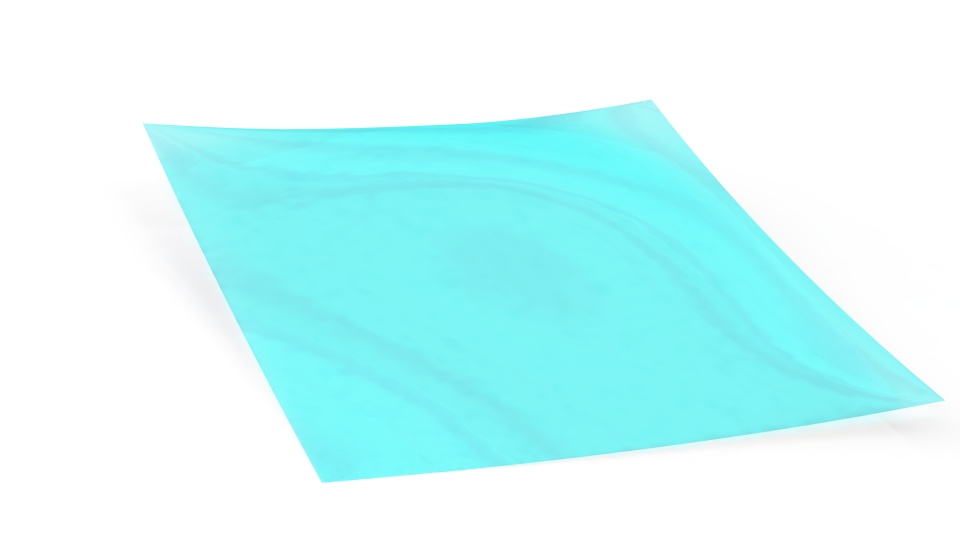

I suggest making the ocean as surfaces that touch some vertical sketch lines. Then vary those sketch line lengths over time to get that ocean swell effect. Then apply a water/ocean appearance.
In your finished animation, use the option to save as a series of rendered BMP files (1 per frame). Then use QuickTime Pro to save the frames as a MP4 movie.

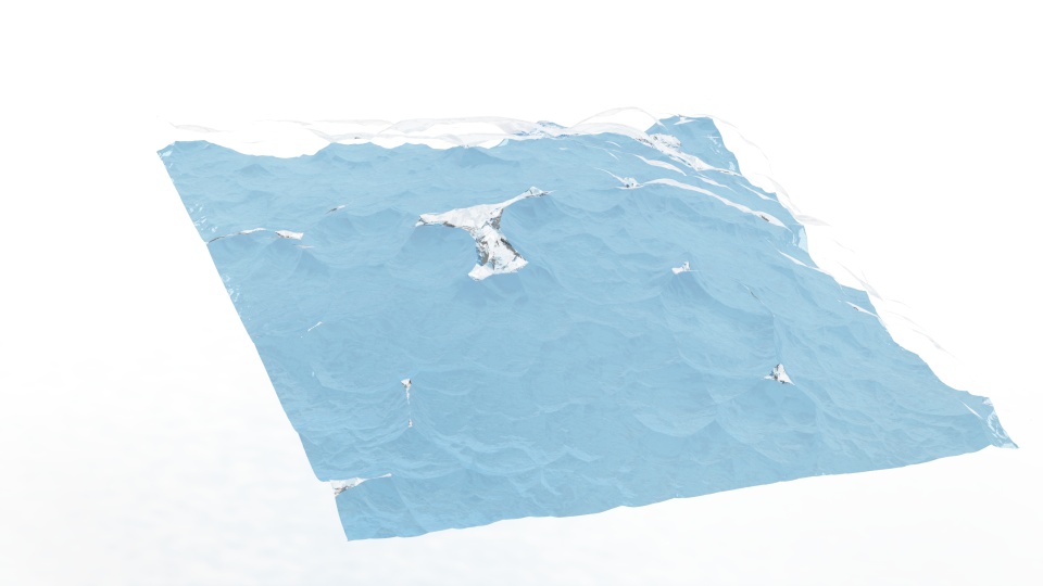

I did a quick "Ocean Swell" part (20'x20') to show using a surface that has its height controlled by vertical sketch lines. Then end points are connected by splines.
I then used the best available PhotoView 360 appearance (rippled water).
I then checked out the other Modo appearances we have access to (via the main screen of customer log on) and found Ocean!
The Foundry Asset Sharing: fs_OceanAnimated
I created a second configuration and rendered it.

Best and easiest way to achieve the "wave water" is to create a surface plane then apply the heavy rippled water (slight ripple will work as well with adjusted settings) appearance in SolidWorks.  If you adjust the mapping size and use displacement instead of bump you get a very similar look to the Modo appearance.
You can use the Modo appearance as well you'll just have less adjustment.
If you don't know rendering or animation Mark you have a long road ahead of you for this project.  Modo will do a better job than PV360 but its NOT easy software to use and isn't something you just pic up in a day or two of using it.
