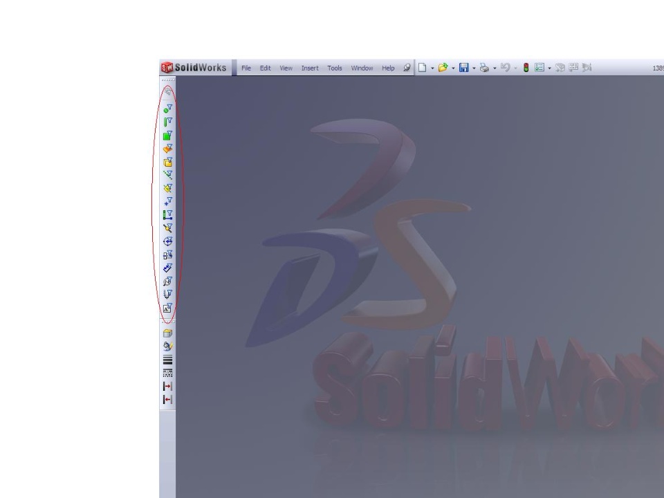

RMB in your menu area, turn on the 'selection filter' menu, see attached photo.  Hit one of the filter buttons, now you can only select whatever entity is 'filetered'.
