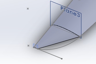

I am trying to design a wingtip for an aircraft I am trying to build. It will be a very low cost "FPV" platform with elliptical wingtips. I could work with the current wingtips, but I am not sure why they wont conform to the guide curve.Image result for raked wing This is what it currently looks like, its OK.

I am not sure why, but if you convert your lines in the profile sketches to construction lines, then a Boundary-Surface will work. It should not be like that as the selection manager should produce the same results but it does not.
Also for some reason Loft or Boundary-Boss creates self-intersecting geometry.
However Boundary-Surface and Surface-Plane followed by Knit does produce the wing tip. I haven't tried Lofted Surface though.

Thank you very much. I did not know that open guide curves and boundary surfaces can be used.
Almost finished!
