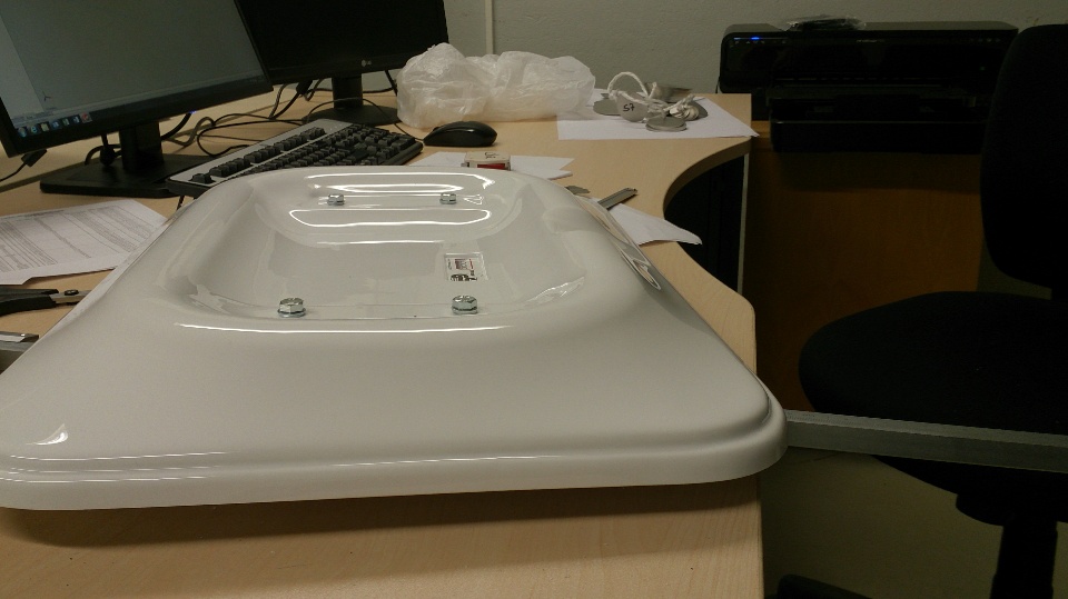

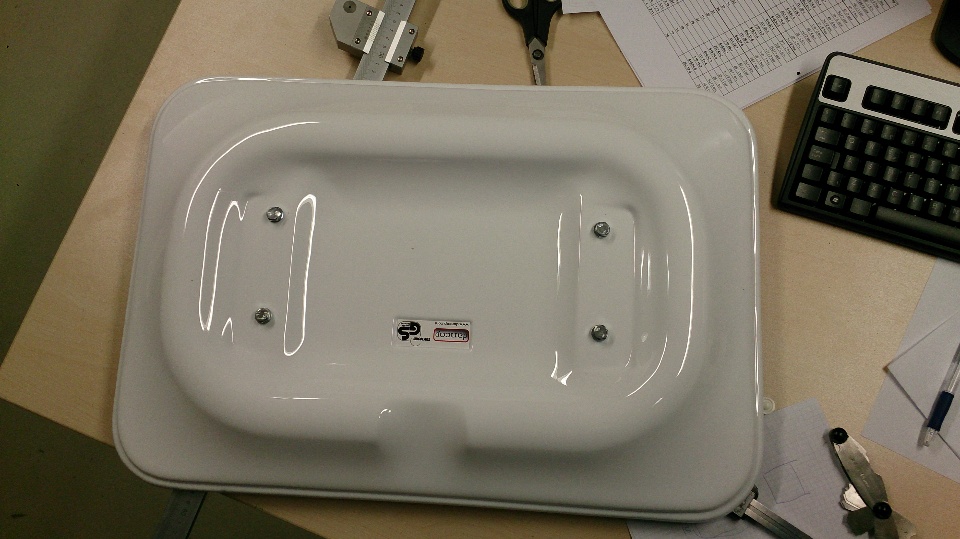

I'm trying to create a background for a mirror. I just can't figure out how to do a part of it.
I've tried to use lofted surface but I can't get it right
I don't know if you get an idea how it should be shaped ?
However it's the rounded part in top and the curved edge around it I can't get right. Any idea how I could do it ? If I use lofted surface it won't follow the edge of the "pipe" i drew,,, I'm really confused here.

Two methods to get you started.
LB
LB 2013-11-14
This is a vacuum formed or even a press formed piece to make the cover for the mirror, the concaved area is a result of the let call it the doughnut shape to the stepped detail where the mirror goes, this is kind of hard to mimic.
Marks model kind of illistrates this without the angled face.
but to get the concave make the to straight line ends curved.

Thank you guys,, I was so close to do it right But thank you very much for the quick responce
