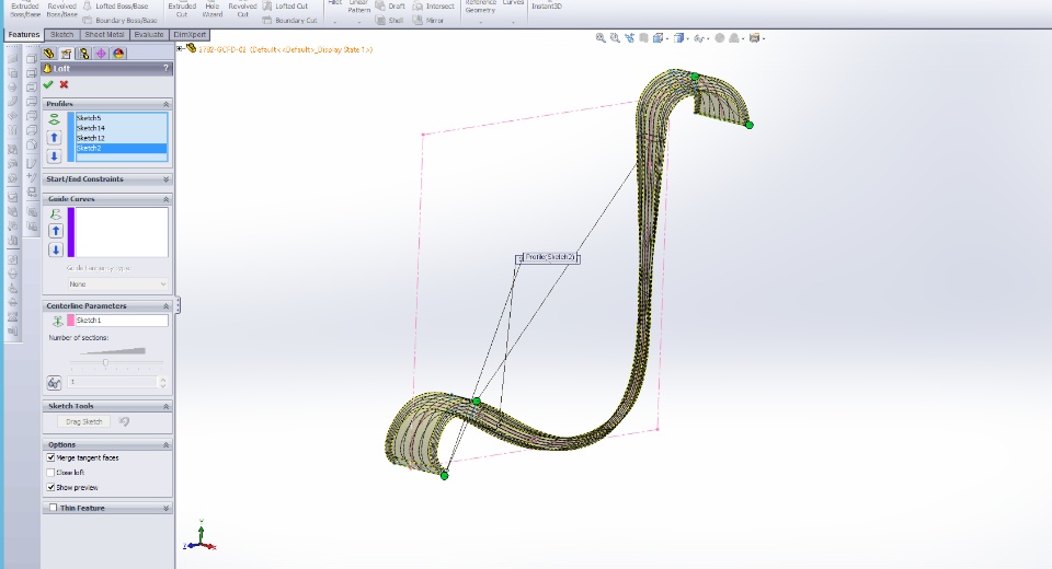

Hello,
I am trying to loft along a splin line on a single plane with multiple profile sizes along a center line. as you can see in the picture i start out from a 1/8" x 1 1/2" to 3/4 x 5/8 than i go to another profile  at 3/4 x 5/8 than back to a 1/8"x1 1/2" ... WHY is it not staying consistant shape between the two 3/4x5/8 profiles? attached is the file.
SolidworksParts And Features
Answers 1
JF
JF 2013-09-20 Best Answer
because you told it to loft between all four profiles. that causes it to interpolate the edges so that the edges are not perpendicular to the profiles at your sketches.
to get it to be a contsant section in the middle, make a sweep for that section, then use lofts (or boundaries) for the ends.
