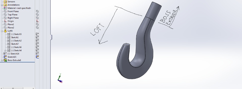

I am trying to create 'hook' with the loft feature. The start and end profiles are both circles, but when I create the loft, it looks like the ends of the solid aren't perfectly round, it's like they're made of 3 arcs instead.
The curved lines you see aren't supposed to be there, how do I fix this?
I am inserting an image for better understanding. When I continued with boss extrude upwards, there were no lines.
Any help would be most appreciated.

Welcome to SolidWorks forums Tina.
Those can be the tangent lines. Can you please attach the part file to check/verify.

I'm not sure these lines are tangent lines. When I try to select the circle on the top, it only selects the arc between the lines instead.
It's difficult to explain in writing so, as you have suggested, I'm attaching the file of my part.

For the top cylinder create a new sketch, use a circle as your sketch. extrude the circle upwards and you will no longer have the three lines. For the hook tip you can offset a plane from the existing surface at a distance of 20.91mm. create a point on this surface and use the loft feature. Loft between the surface and the point. Use a start constraint of tangancy to face and an end constraint of normal to profile. You may have to hide your existing sketch14 to create the loft.

I am still curious if there's a way to hide those lines, because they also appear on the drawing. The hidden tangent edges doesn't seam to work. Any ideas?

If you right click on a line you don't want in your drawing at the very top of the box that pops up you will see an icon. it has 2 vertical lines one black on the left and a red one on the right with two arrows in the center hit this and the line you don't want will disappear. Note: on your hook tip, it is made up of more that one line so you will have to select lines more that once in that area. The top cylinder area should be just one line. Tom

For those trying to hide complicated surface 'edge' lines, if you have multiple lines over the top of each other they can be really hard to select, try using the 'select other' function to cycle through these. Its in the right click (RMB) menu.
