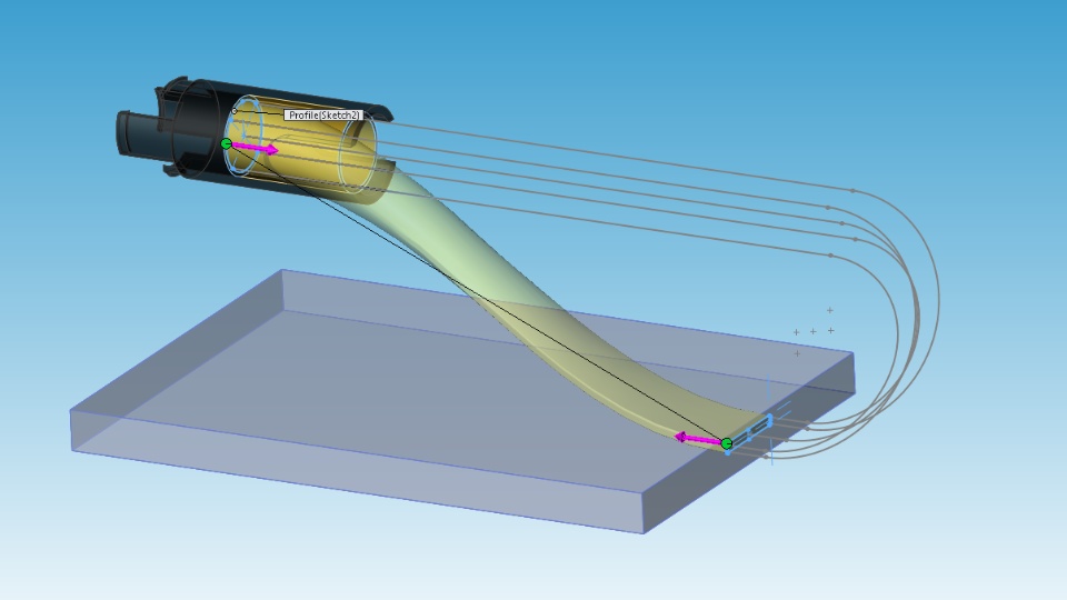

I need some help. I am trying to create what I would assume to be a loft. I don't particularly care if it is a surface or a extrude, I just need it to go around a curve, but I cannot get it to work. I need to somehow tell it to change directions from the bottom sketch, but when I do that in the loft command it doesn't work. I am trying to do this in the context of an assembly to join the two parts with a third part (bundle of fiber optic strands) Any assistance would be greatly appreciated. I have attached the file as well.

Couple of tips
Each profile sketch needs to have the same amount of segments doesn't matter if it is a circle, you need to split the sketch, in this example I chose 8 segments which follows a rectangle with radiused corners
Sketch 1 = Yellow
Sketch 2 = Orange
Sketch 3 = Green
Sketch 4 = Blue
Loft center line is Red
When lofting show all the sketches and click on the sketch in your window not the feature tree and always pick the same point in each sketch, once you pick the multiple sketches, select the center line and should be good to go.....
