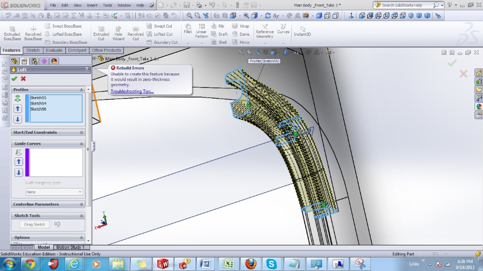

I'm having difficulties creating loft over 3 sketch drawins on 3 planes.
For some reason I keep getting the error message "Rebuild Error: Unable to create this feature because tit woul resul tin zero-thickness geometry."
Any help with fixing this would be appreciated.
A copy of the file in attaached.

I didn't open your file, but is the lofted feature joining with an existing body in the part? That could be where the zero thickness error is happening.

Yes the lofted feaure is joining with an existing body. How do i make it connect properly?
Or are there alternaties to resolve this problem and perhaps make it join with the existing body without errors? I'm coming across the same rebuild error in a sweep boss operation as well. Perhaps i'm not connecting the  new sketch to the existing drawing properly or am I missing something?

A good bit of the geometry looks very rough and most (all?) sketches are not fully defined.
Did you really intend to do the first Revlove as a Thin Feature resulting in this tiny gap in the feature?
I suspect the geometry can be significantly simplified (and more aesthetic) with a Sweep feature.
Cut Extrude 22 is ambiguous on one end (and although I haven't looked real close it looks like the entire model could have been made with three simple features up to the point of this extrude).
What version of SolidWorks are you using - maybe I could attach an alternative technique?
You can use existing workplanes to Split parts rather than Cut-Extrudes.
I find some little bits of geometry and missing tangent relations in a sketch that would cause a Sweep to stop.

No I didnt mean to do the first Revlove as a Thin Feature resulting in that tiny gap. Its my first time using the solidworks really, so theres been some errors along the way, and you rightly pointed out one of them. Thanks for pointing that out.
Could you please suggest ways to make the sketches more fully defined? I think that could be main cause of the zero thickness geometry error that keeps popping up in the sweep and loft operations Im atempting. Jerry's suggestion about the sketch no tjoining with the existing parts properly seems to also be a possible cause.

Yes, you need to get your tangencies and connect the sweep profile to the sweep path.

Okay Thanks, I was able to get it to work on the sweep.
How do I apply that for the Loft ot get rid of the rrors or make my drawing more fully defined.?
