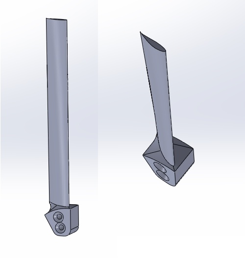

I have a model of a small aerofoil section blade for an experimental rig and I am trying to make a drawing from this. The blade model is as in the image below. The loft which forms the actual blade is not visible when the blade is imported into a drawing. I have played around with the various different tanget edge visibility settings but the edges of the loft are still not visible. The drawing that results shows that both the start and end curves of the loft are visible but that the body is not. Does anybody know what might be causing this?

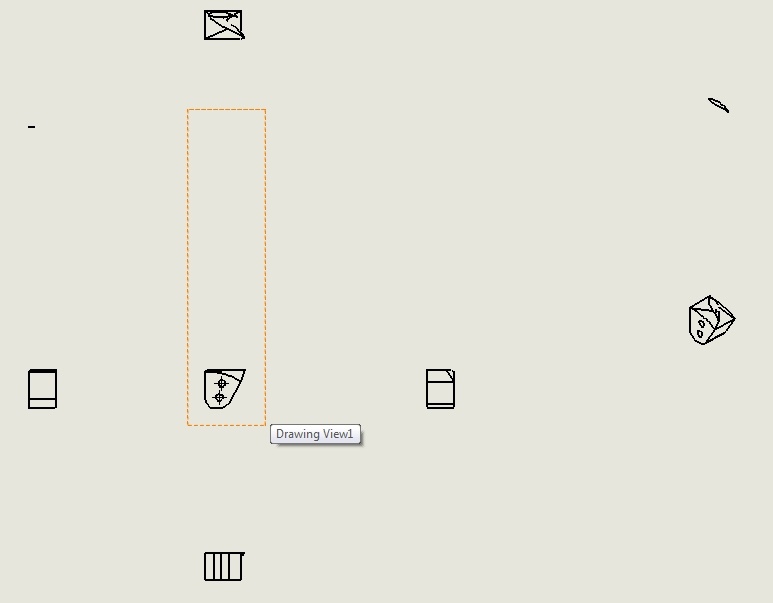

Mark, the image quality settings do appear to change the view. When the settings are set to high quality the images appear as in my original post. When set to draft quality they appear as in the attached image.

here is what you do to your part, go to the 2 sketches that were used to create the loft, break the single spline into a top curve and a bottom curve at the leading and trailing edges on both. then you should have something that the drawing will reconize.
other thing you can do is use the mold tools parting line, I use this alot for machining airfoils that come in as yours is created, that way I have a hard edge for the CAM software.
or put up your part and I'll show you

SF 2013-08-14
Great thanks for your help everyone. Lenny, your solution works like a charm.
