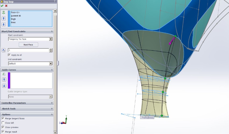

I'm having a problem with a loft. I'm not sure how to describe it so it's hard to search for. I'm sure you'll able to spot it pretty quickly at this link...
Sketchfab_Publisher_test_003 by Daniel Cane - 3D model - Sketchfab
The thigh of the chicken is lofted from the torso to the knee, but it has aberrations where it's kinking.
It's lofted from a face in the body, through three sketches. It's start constrained tangent to face - which is important to make it look as smooth as possible.
So far I've tried:
- Boundary loft instead
- Converting the edge of the Face to a 3D sketch and adding points to the sketch to create a reference, then creating front and back guide curves for the loft.
- Tweaking the dimensioning of the extruded cut which created the Face.
- Meddling with the green toggle locations and the pink arrow values
- Trying all start / end constraints
- Not using the top sketch in the loft (closest to the face)
- Adding another sketch (closer to the face)
None of that helped so any thoughts I'd be very glad to hear if anyone has time please.
