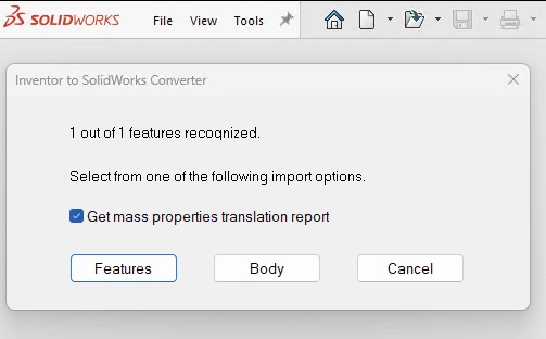

LoadFile4 pops up "Inventor to Solidworks Converter". But I want 'Body' options silently chosen for the operation. How to suppress the dialog showing-up.
Dear Members,
In Solidworks 2025, LoadFile4() API with an inventor part (for example, ‘sample.ipt’ from Inventor 2024) pops up the following import options dialog in the UI, And I have to choose the ‘Body’ options to proceed to load it. But I want to silently proceed with ‘Body’ option automatically chosen for the operations to continue. Can you clarify the solutions available in Solidworks settings/options/API arguments/Registry settings for it ?

Do you need Import Diagnostics to run?  I wrote some quick code, and the dialog does not come up.  Which method are you using to get Import Diagnostics to run?

No, i didn't need to run import diagnostics. I was just opening the ipt file using LoadFile4() API. But, by looking at your code, i set the 'multicad_enable3dinterconnect' to false. then, it worked without showing up any dialog.  Thanks for your response. It helped me to resolve the issue. Thanks a lot.
