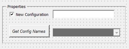

I am trying to get a list of the current configuration names of a part in order to populate those names in a comboBox (On a Form).
I followed the example from : 2015 SOLIDWORKS API Help - Get List of Configurations Example (VBA)
In the example, it spits out the configuration names using a msgbox. I need to put it in an array and then populate that into the comboBox so that the user can select which configuration they would like to make the changes to.
The issue with my code is that only the last configuration is being listed (I'm assuming that the UBound has something to do with it?)
How can i rewrite the code so that the list will populate correctly?
