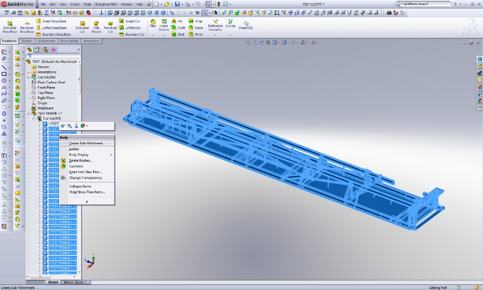

This is Ryan from PipeWranglers.  I just stumbled upon this and don't know if you guys were able to get something working or not but I have a solution to your problem.  You can insert your "original" weldment into another weldment as a part, don't worry about the custom properties checkbox, just insert it and hit the green check mark and it will put it at the origin.  Now when you update the Cut List it will show all the Items from the original weldment as Cut List Items again.  You do not want this right?  So, go to the part in the Tree and  expand the part to see all the bodies, select all the bodies, right click and then Create a Sub Weldment (see first picture).  Now update you Cut List again and all the original Items should be replaced with a single Item representing your old part.  You can then input the custom properties you want to describe it in your Cut List.  I tried it with one of our Wrangler Frames and it worked fine.  It stayed linked so that if I made a change to the original part, that change was carried over to the new weldment.  Also, any new bodies that you create in the new weldment will of course show up as Cut List Items.
