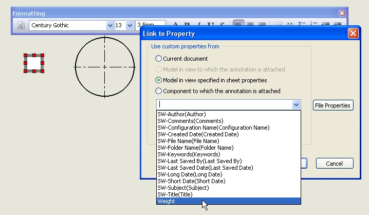

Linking note showing weight to part in the drawing.
I want to add the weight of some glass panels to a drawing, but using the link option so the weight updates if i change the model. i know how to link other properties like scale etc in notes, but there doesnt seem to be an option for the weight property?

Simply click create a property Weight in the part and then link that to the note.

Deepak, could you explain further? cant see what you mean?
DG
DG 2010-12-23
Greg check the picture if that makes a sense. I have created a custom property named Weight in the part and set its value equal to mass. Now I have the note set to the this property.

Ok, how do you create a custom property in a part and set its value equal to mass?

Check the attached video. You can type the property or select from the drop down list. Then you can link to the note in a similar way you do for your title block.
I have showed both the ways and link to both the properties.

Thanks Deepak, that explained it perfectly!
Got it working fine.
