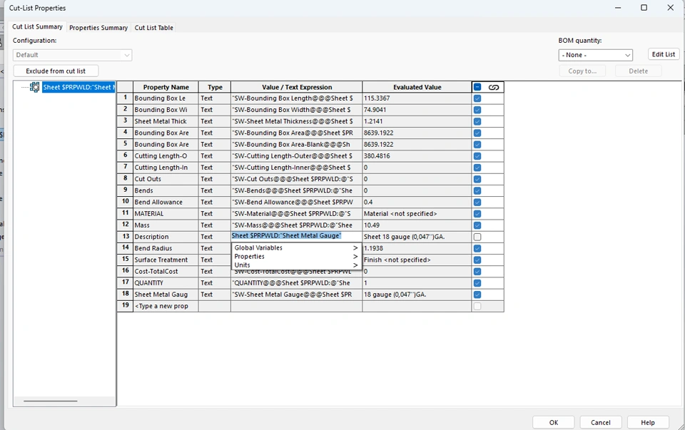

I am trying to Link the gauge property to The weldment body description, then when I generate my weldment cut list, the Gauge of the sheet metal is already in the description, but I have faced a small Issue.
I have used the Name :
Sheet \\\$PRPWLD:"Sheet Metal Gauge"
as a Sheet Metal Bodies description, but Solidworks Output an error.  To have the system evaluate correctly, I have to ask stop linking and retype one character of the string. It is a hassle that it doesn't work right away, Does anyone have an idea how to make this element work?  Do I need to submit this to SW or my reseller?
Kind regards
Edit : This was done with SW2024 SP2.  When updating to SP5, the second image did not happen.

Not sure if it will make a difference, but what happens if you update your part template like below?

John, This option does not changes the result, thank you for your input.  I have talked with my VAR today and they told me this field is not a dynamic field.  I have made an enhancement request for Solidworks.
