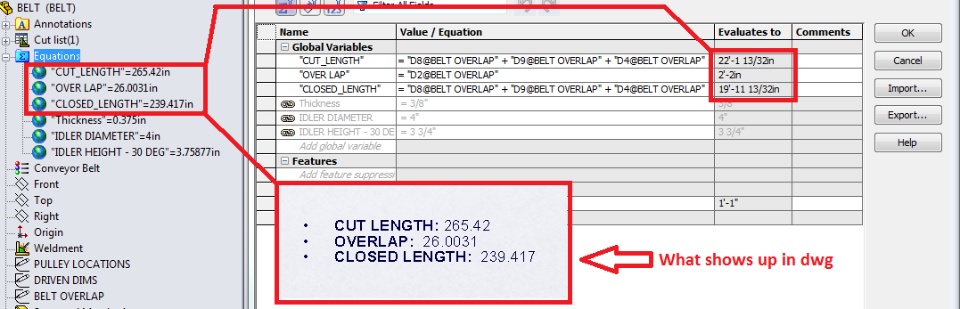

Inside the "manage equations" dialogue, my dimensions show as a fraction, but in the tree, it shows as decimal. This is causing it to show as a decimal when I link a note inside the dwg. I need it to show as a fraction. Am I missing something? Picture should explain it all.

In your drawing's Document Properties, are Units set to decimal or fraction (Tools > Options > Document Properties > Units)?

They are set to fraction in both part and dwg

Here is the part/dwg
Thanks for the help
It is in 2013

Is this checked?  I'll bet that's it.

Unfortunately, changing that didn't affect it
Here are my DWG units
Here are my part units
comment imagecomment imagecomment imagecomment image

I'm not on 13 yet, but have you tried setting them both to the same fraction (16 or 32)?

Thanks for the help guys, but it is stil showing as decimal.

Have you tried creating a new note that links to it?  Maybe the old one just didn't update after clicking the "Round to Nearest Fraction" button.

It was checked from the get-go.. I'lll delete the note and give it a shot. Just seems strange the the global variables in the tree are decimal, while the eqtn box shows fractions

Still doing it... darn
