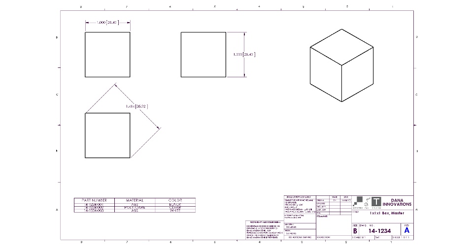

I am trying to create a drawing that has a parent part number which represents the geometry of the part we are creating (12-1234) . I have configurations with separate part numbers (12-1234-001, 12-1234-002, 12-1234-003, etc.) They have different properties from the other configurations such as material, color, etc. I want to be able to create one drawing with one view of the parent part number (12-1234) and have a table that reflects configuration specific properties so they will update when theyre updated in the model. Is there a way to do this with syntax such as \\\$PRP@CONFIGURATION<1>:"PART_NUMBER"? or something like that? I am not familiar enough with the syntax to come up with any other ideas.
Here is what I want it to look like, but I have entered the table info manually.
