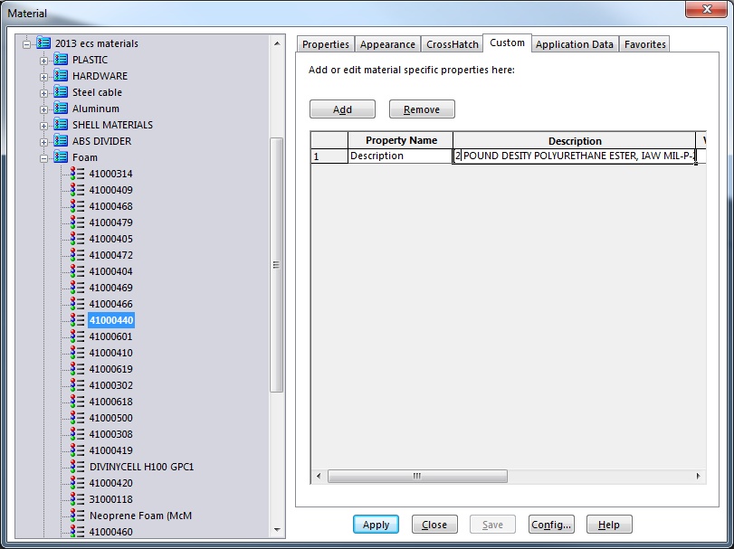

I have a custom material in my materials library for some foam. Within that foam material, I have a custom property with the property name 'Description', and in the Description field, I have the type of foam that it is calling out so that my vendors know what type of foam to use based on the material that I have. (I also have the same info on the "Properties' Tab/'Description' of the material as well in hopes that I could maybe get that to work as well).
What I want to do, is in the file properties, have it link to the custom material property description that I created so that when I go to create a drawing of the custom foam, a Note is then linked to the custom property and will auto populate the description that I placed on the material. I would like this to be at the template level, and as you can see from the pictures below, there are ~30 foam materials and the field would need to be updated if the user decided to change what foam was being used at the part level. I might be asking for too much here, but to get it to work for multibodies with different materials would be great too.
I was able to get the material to populate on the custom property by using the command "SW-Material@Part1.SLDPRT", but I am not sure how to link to a sub property of the material.
Any thoughts?

David,
Look at this discussion​
I think you need a macro to extract the properties
Hope this help you to get started

I took a look at both of the links. Basically, they both seem Greek to me with having to do stuff with the XML-parsers. I may need to wait until SolidWorks comes up with a fix for this. Using the parsers, would this be something that would need to be done on every computer on the network, or just one that everyone can then access?
Thanks
