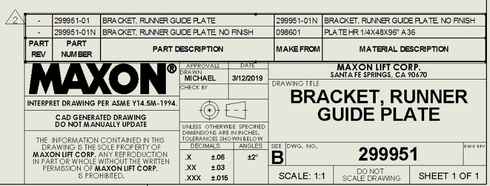

My company still uses Excel based tables in the drawing templates.
So been trying to write a Script that will get Part Numbers & Description from parts or assemblies with multiple configurations.
Our current table you have to manual type in the part numbers. The Excel table is linked to our DBWorks Vault.
So when you type the part number the description automatically fill.
This method is horrible, slow & sometimes the Excel Table get corrupted & corrupts the entire drawing file.
Its painful to use this table when you have 10+ configurations you have to fill in.
So I figure write a script that will generate a SolidWorks General Table with all the configurations.

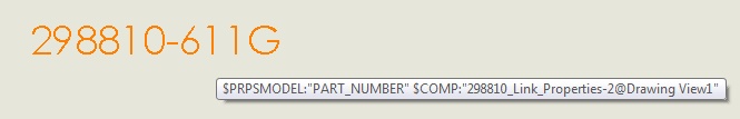

I can see the Link To Property works perfect.
Variable Link shows:
\\\$PRPSMODEL:"PART_NUMBER" \\\$COMP:"298810_Link_Properties-2@Drawing View1"
From what I under stand of this variable.
\\\$PRPSMODEL:"PART_NUMBER" <---Model Custom Property "PART_NUMBER"
\\\$COMP:"298810_Link_Properties-2 <---Assembly File Name
@Drawing View1 <--- The active configuration
