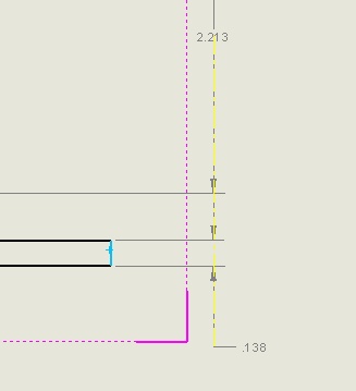

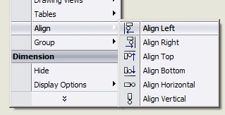

Any chance if you asking for aligning them. If yes, then select the dimensions, right click and then choose the appropriate Align option.
Also when you're placing a dimension, you should be able to see a auto snap in line with an adjacent dimension (yellow in color)

Deepak,
You are using 2009 right?
that align option you are talking about is not there in 2010.  When I RC
the only option I see is align to edge.  Not what you are showing in your pic.

to get what deepak shows you have to ctrl two or more dims then right click.

Auto align works for both types of dimensions. And to get the align option, you need to select more than one dimension.

Scott, one thing i have noticed is you have to be able to see both dims on screen for auto align to work. even if you can see the dim line it is no good, you must be able to see the actual "size".

The menu showed up once I used the control key.
And I did notice and it kind of makes sense that both dims have to be in view.
I just want back what Deepak showed with the yellow snap line.

Scott, i do get the yellow snap line, but only in horizontal and vertically placed dims. i also want it on angled placed dims.

maybe this setting? (disable note/dimension inference)

Jeremy, that's it !!!!
Thank you.
SM
SM 2010-09-15
Jeremy found it.  Haven't tried it with angular dimensions.
But it gave me what I was looking for with the yellow snap line.

The Disable note/dimension inference option is at Tools > Options > System Options > Drawings
