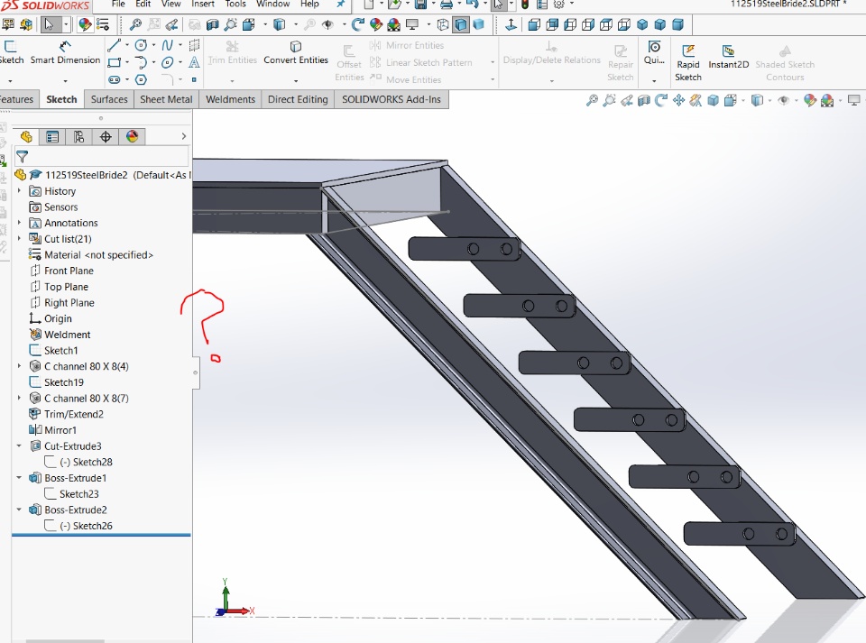

I'm trying to sketch these stairs. I need to make some change but can't find the Linear sketch pattern in the feature tree.
Does this mean that Linear patterns cannot be edited and my only option is to delete that sketch and start again ?

RM
RM 2021-04-08
The linear sketch pattern is not something that shows up in the tree.
It lives within the sketch that defines the "patterned feature."
Edit the sketch that defines this patterned feature.  I'm assuming it's the treads in this case.
Right click on one of the patterned sketch entities and select "Edit Linear Pattern" to make changes.
Hope this helps,
Ray

1) A linear Sketch pattern is specifically for patterning geometry from inside a sketch.  So, in order to use it, you need sketch geometry inside a sketch first.  However, like Glenn mentioned, sketch patterns tend to be problematic the more complex you make them.
2) What you are probably really looking for is a body or feature pattern.  Which would be under your features tab.
Body patterns are more robust, but you can do either one.

In the future I would strongly recommend avoiding sketch patterns.  Create a single instance and then pattern the feature or body instead.
