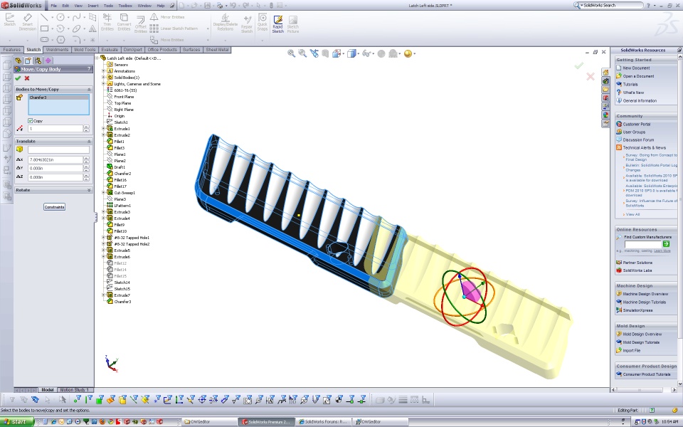

you can also use the move/copy solid option.
SF
SF 2010-06-03
That appears like it would work, but I'd like to merge bodies.
Thanks for the tip though!

LB 2010-06-03
can do that from features/combine tool, allows you to add, subtract and get the intersection of bodies. it's about 3/4 of the way down a yellow and green cubs icon
