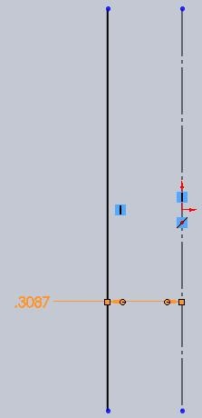

You know how when you insert a linear dimension between two entities, if you place the dimension off to the side, it decides that you actually want the dimension between the entities to be just half the dimension you enter? What is that called? And how can I turn it off forever?

Are you dimensioning center line/construction line and any other entity.

In this case I was dimensioning from a construction line to a point.

When we dimension across a center line or construction wrt to any other entity, it tends to take the diametrical value. If you move the dimension to side while dimensioning, it will take the radial dimension. So I feel this is expected behavior and I'm not sure if there is any option to switch it off. What you can do it change your center line/construction to a solid line and after dimension change it back to center line/construction or use a solid line first and then convert it to center line/construction. I believe this make some sense.

Thanks for the explanation and for pointing out that this is just the case with construction lines. I don't like it though and wish I could switch it off. I don't think of construction lines as centerlines (unless that's why I'm using it)- they can represent anything. And if I am pulling a dimension to the side it's because I need to avoid another entity so it doesn't try to dimension to it also. The halved dimension always catches me by surprise and is annoying/ causes errors. So if I had a choice I would switch it off.
Do people use centerlines with intent to dimension in this way? Maybe I should just get used to it and make it work for me.

Yes, I use them when I'm working with cylindrical parts/shapes.

Well, I guess it's my problem then. It helps to know that it's a deliberate centerline thing. I thought it was random and for any kind of entity.
Now that I know when and why it happens I can teach myself to work with it. Thanks Deepak!

Just make sure to place the dimension on the side of the solid entity (point, line, etc) to get what you want. After placing the dimension there, you can drag it to wherever you want.

This feature is actually very useful for designing revolved features.  Design intent for revolved features very often involves diameters rather than radius.
You should get a preview of the dimension as soon as you click the second entity.  If you will RMB while the preview is in the orientation you want it will stay that way even if you drag it to the other side of the center/construction line.

It's one of the things you need to know about construction lines and dimensions. I was bitten by that one time, I dimensioned to a construction line and accidentally got the wrong dimension, at the same time I often use construction lines as centerlines and like the way it gives the option of ether a diameter or radial dimension.

Interesting takes everybody. OK, I'll stop complaining about it. Now that I know how it works maybe I'll be saying I can't live without it in a few weeks. Though I haven't needed to make a revolved feature since 2007. The year, not the version.
