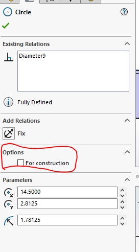

Are you able to toggle between contruction and not depending on a which configuration a part file is in?
I know you can modify dimensions based on configuration but I'm wondering if you toggle the " For Construction"?
I don't think so.
Unfortunately, you cannot.
However, you CAN create another sketch using the "convert entities" and then have 1 suppressed and the other not suppressed. You CAN control that with configurations.
