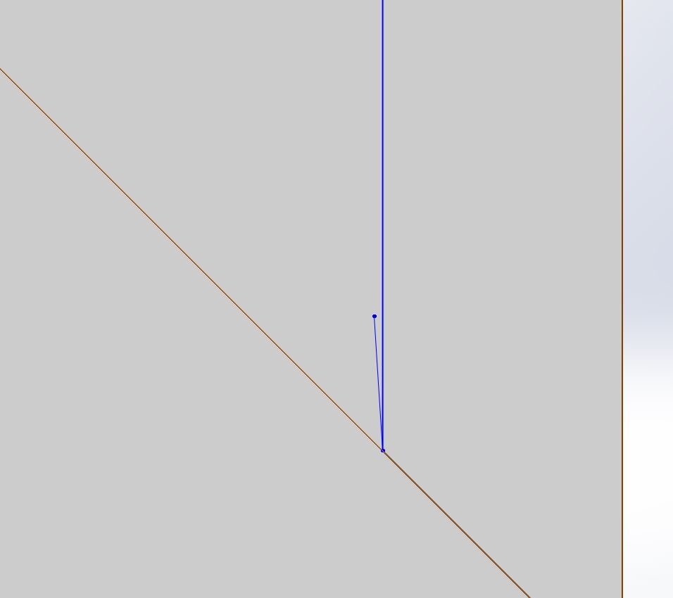

When drawing lines which merge to a point or edge, I regularly (60% of the time) get a small line created after the click. This is VERY frustrating. Why does it happen and how do I prevent it? Is it a hardware issue?

Aaaaaand again.
comment imagecomment image

I believe it is mouse sensitivity.
SF
SF 2015-03-17
Low or high? And would that be sensitivity on the click or the cursor?
TC
TC 2015-03-17
I think its high and on the click.
JW
JW 2015-03-17
I believe that it comes from the way the mouse is being used. If you click and release to start the line and then click again to place the end point this will happen sometimes depending on the duration of the click. If you click and hold the button when you start the line and then move the mouse to the end point and release the button you will get your line without the second line.
