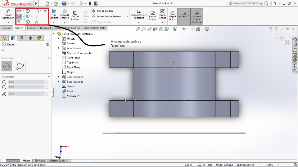

I am new at using Solidworks and I have some how managed to remove certain drawing tools for my ribbon, please see image attached. How can I rectify this to have the standard drawing tools visible again. Thanks in advance.

You can right click the uppermost toolbar (Command Manager) ... Then select "Customize"
Then you can select the line tool from any of the many areas it can be found, simply drag and drop it onto your toolbar where you would like it ...

It looks like you're in the circle tool...

Thank you very much for the help. I feel very silly now, seeing that the solution is so simple.

not a big deal to loose your tool bars.....especially when they are way up there in the top of the screen......options other than returning the tool bar as shown by John.  Use some keyboard short cuts....default setting "L" to draw a line.  Another option is to right click if you are in a sketch and the line command should be there too.
