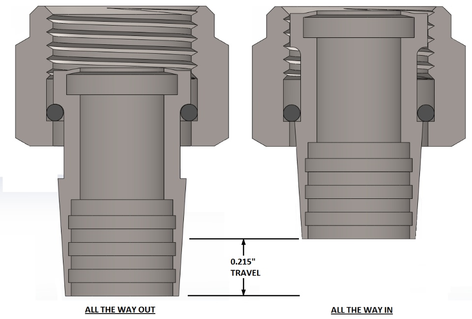

I am making an assembly of tube fitting but I am having trouble trying to limit the range of motion on the fitting end.  The maximum travel distance is .215" between the edge of the pin and the floating fitting end. I've attached a picture that should make things pretty clear.  Any ideas on how I can accomplish this?

Christopher,
I don't use Limit Mates very often, but can't you just set up a Limit Mate with your floating fitting and another part?

Thanks a million Glenn.  You gave me an idea!!!  I just created a plane above the part and used that to set my limit dimensions off of.  You could do the same thing with another part as well.

You can mate the part to a face, plane, etc. of another part, and the limit isn't 1", here is one with 1/2" total travel.

I apologize...I was apparently picking the wrong surface when doing the mate so it wouldn't let me go less than an inch.  I've got it working now.  I will take more time to check everything then double check it before I post next time.

likely your issue was not the surface you picked, but rather the parts starting position. when you enter the values into the mate properties, ALL of the values must be valid. so if the current distance is 1.125", you can't set the maximum to be less than 1.125", until you change the current distance to a lower number.

That is exactly what happened.  I should have known better than to think the fine developers would make the limit distnace min 1.00".....that's just absurd!!!   Thanks again for all your help fellas!!!
