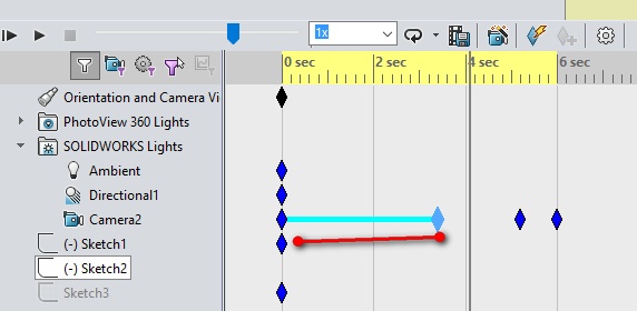

Hello!
sorry if it is a stupid question but
I see this in SW
and do not see this light blue on 2016 SOLIDWORKS Help - Changebars . May be some other part of Help covers it?
And what is the difference between time moments inside blue line and outside of it?
Thank you!
SolidworksMotion Studies

LP 2017-04-09 Best Answer
Hi Ivan,
I believe this light blue bar is specific to camera transitions, I can't see it anywhere else in the help menu though.
The blue line indicates a smooth transition between one time moment and another, for example if it were a part time and at one point the part was visible and the next it wasn't the transition will slowly fade the part away. If the next key does not have a transition and it will make the part re-appear, then the part will re-appear immediately.
