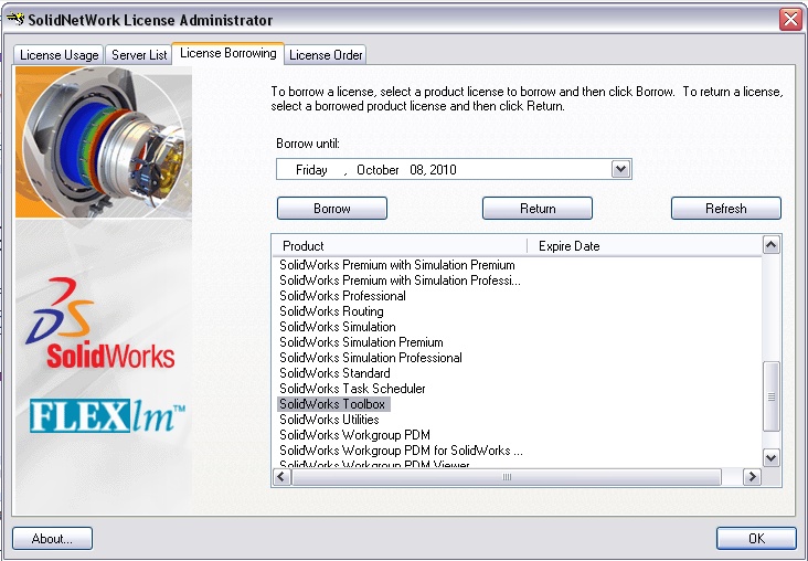

Recently upgraded our company to 2010 and am pretty new to Solidworks.  Anyway, I recently had a user complain that they were unable to use their Professional license because someone in another branch (who doesn't need access to it, only standard) had grabbed it.  Is there any way to specify who would receive a professional license vs. who would not?  Is it something that needs to be done during installation, or can it be changed afterward?

no there is not a way to reserve it...but the person that needs it all the time can check it out and keep it for 1 believe 20 to 30 days, but taht being said he would have to check it back in for other to use.

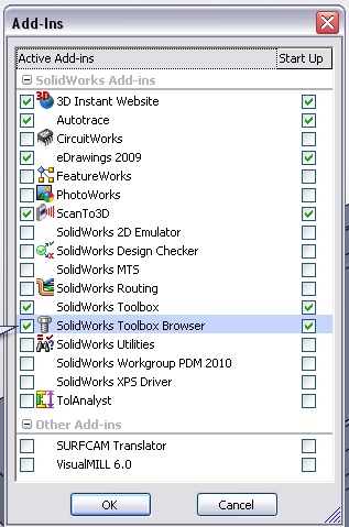

make sure the people that don't need it turn off the items that the office prem and pro use, toolbox is probably the culprit, make sure they don't have the add-ins set to automaticly turn on at startup.
