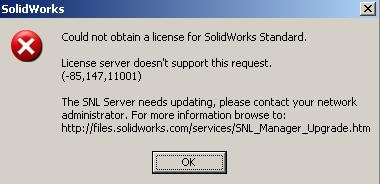

We had to move our license server recently since the old computer died. After switching, I changed the server info through the License Manager. Now my SolidWorks client no longer acquires a license. It gives the following error box, which I also attached as a screen-shot.
<br>"<br>Could not obtain a license for Solid Works Standard.<br><br>License server doesn’t support this request.<br><br>(-85,147,11001)<br><br>The SNL Server needs updating1 please contact your network<br><br>administrator, For more information browse to:<br><br>http:/fFiles.solidworks.com/services/SNLjlanageçUpgrade.htm
The computer administrator says that other people's installations have all worked. I have an installation both on my desktop and my laptop, running different OS's (Windows 7 and XP), and different versions of SolidWorks (32bit and 64 bit), and both give the same error. I am not on the same local subnet as other people, but the administrator said that it works for other people both on and off-campus, and that the license server has no permissions restrictions.

WF 2011-03-21 Best Answer
Mike, it sounds as if you are running a new version of SW than your license server.  Did you install an older version on the server?
SF
SF 2011-03-21
I don't think that's the case. I suppose it's possible, but:
My version was working just fine before we moved the license server.
We all use the same installation DVD. I assume at least some of the others have installed the latest version too.
So the only way that would happen is if the administrator somehow used the wrong cd to install the license server, and the others were all using older versions, is that correct?

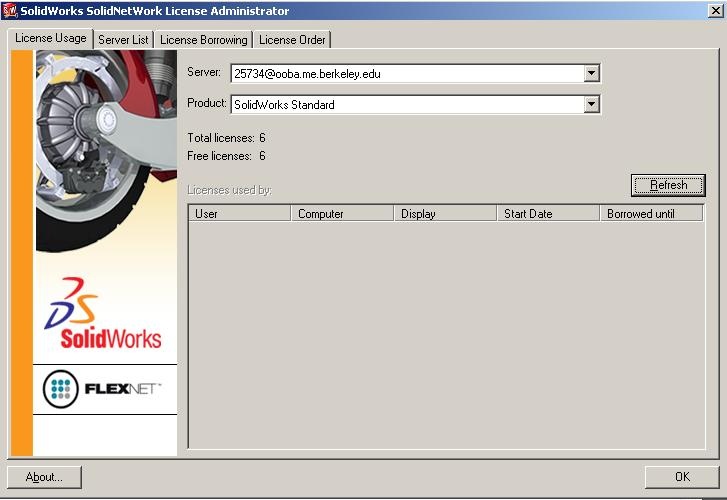

Also I should add that my License Manager actually does show the correct info on licenses. I also tried running the SolidWorks update on my laptop, to see if that would fix it. At one point during the install, it asked for my license server info. I gave it the new server info and it seemed to accept it just fine.
I've attached the License Manager screenshot.

SF
SF 2011-03-21
Hey Walter,
Just checked with the administrator, and it turns out you are right! Apparently, SolidWorks increased the version on my computers because I let it update itself.
Is there a way to update the License Server, or do we have to wait until we get the newer DVD?
