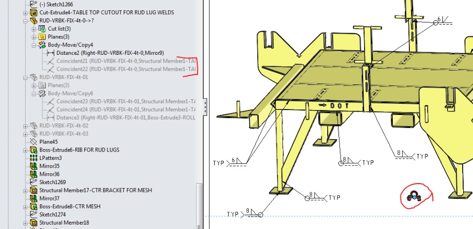

I am using Solidworks 2014 and have designed a Table and created a drawing from the 3D model a while ago but with the same version of Solidworks I am using now.

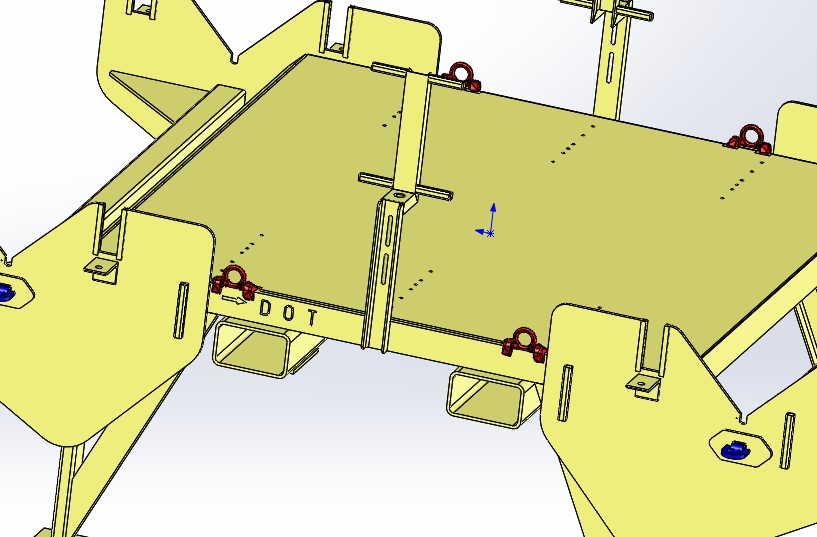

Later I had to add some Rud lugs (in red) from the library to the part (not assembly) and positioned them with the Body/move/copy command.
My 3D model is changed now and looks fine but in the drawing 3 of the 4 rud lugs are hidden/supressed and one is in the wrong position
because the Body/ move constraints are hidden/supressed.
I tried to unhide or unsuppress them but it just doesn't work partly because I don't even have the menu to show or unsuppress anything.
If anyone had this or knows a solution and would share this I would really appreciate it.
I am relatively new to solidworks and have checked the different configuartions if they are making this problem without success and just don't know where else to look.
Thank you in advance!
Gabi

Hello Gabi,
Is it possible that the model has multiple configurations, and the drawing view is referencing a configuration that has these features suppressed? If yes, you can't unsuppress features from a Drawing, but it's pretty simple to make the drawing view reference a different configuration. Click on the drawing view to highlight it, then go to the "Reference Configuration" section of the feature manager and click on the drop-down to show a list of all configurations, and select the desired one.

Hi Glenn,
thank you so much and off course it was the configurations.
I thought I had checked that but obviously not.
Thanks again for your help and have a great weekend
