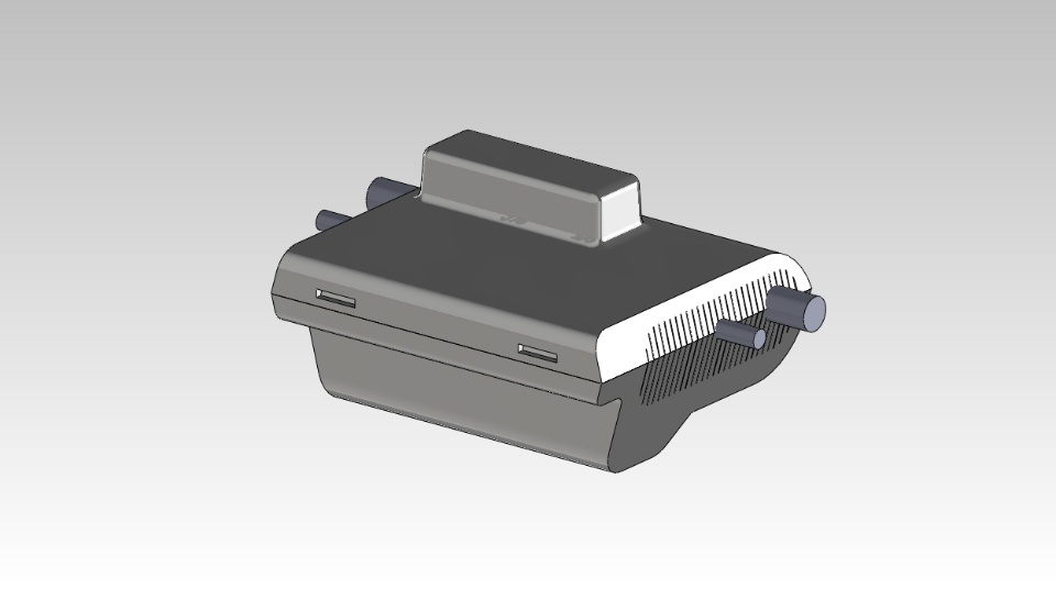

im designing a plastic cover, it has a live hinge,its about the size of a cigar box. i need some latch ideas that are easy to mold but effective. the latch doesnt have to be easy to open because this cover is intended to be perminent, so i need to be able to put the cover over a connector in the field and snap it shut. any ideas would be helpfull.

Scott,
Have you looked at the (Insert, fastenening feature, snap hook) feature? You could face the hook to the outside of the box, have a through hole (square) in the other half. Also look at the SW help on this feature there is a blind pocket option also.

This is a difficult image to interpret but it's a Dremel Tool carry case latch as seen from the bottom side. It's a living hinge design as well.
Here's another like it on a socket set:
By the way, pretty bizarre how the iPad photos are coming in upside down today!

Does the box need to be "dust-tight/dust-proof" or can the snap feature create a hole thru the box?
Is there any way you could post the file, or some screen-shot of the part, or pictures of a similar part?

Scott,
What type of plastic material are you looking?
Can you develop something with a live hinge.
If it is going to be permanent, think of internal snaps.
I developed  parts with live hinge which can be molded one piece.
It's all depends on the internal profile of the box.
Do you have any pictures?

its polypropylene, it has a live hinge.

Scott,
Protomold always has good techniques. http://www.protomold.com/Design_Tips/UnitedStates/2009/2009-02_designtips/
Insert>Fastening Feature>Snap Hook always works, too.
Also worth a read: http://www.protomold.com/Design_Tips/UnitedStates/2010/2010-07_designtips/default.htm
