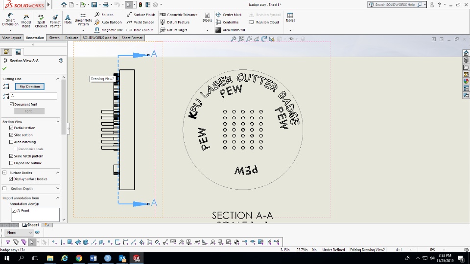

In this case, I made this assembly called "laser cut badge"
    The assembly is made of the following subassemblies
      a) "badge base"
      b) "Badge font": (I set this one up using a custom material setting I made up called "laser cut plastic"
      c) "Badge holes"
I wanted to see if I could get the holes cut first, followed by etching the font, followed by cutting out the part.  This means that I set both the font and holes as EXTRUSIONS so I could provide section views of them.
Here is how I specified the cross hatch of the material "Laser cut plastic".  I set it as a solid cross hatch
                                    (For material "laser cut plastic": Setting the cross hatch pattern)
My goal was to use the solidworks section view of this badge to cut through the font and automatically produce a drawing where the specified material of font subassembly to automatically fill in the font with a solid pattern ready for laser etching.
(Attempt at using Solidworks section-view to automatically fill in cut sections with SOLID FILL instead of HATCH PATTERNS.  I can hide views as necessary afterwards)
Here is a close up view of my results.  (THEY ARE DISAPPOINTING SO FAR)
      How do I make the cut sections appear as SOLID BLACK INFILL instead of a hatch pattern?  I do not want to select each letter (or sub-pattern) individually.
(It's easy in this part, but I have a model of a vernier caliper I am making, and this would be screaming awful to fill in every etch line by hand.)
                              (Disappointing result: Letters show cross hatching, instead of solid infill)
Any suggestions?  I included a "pack-and-go" zip file of this project, including the drawing.

FL 2021-04-08 Best Answer
Select the feature (extrude text) and change appearance to black?
DM
DM 2021-04-08
you do not need to do the section to fill the areas you can use this command
and then fill areas you want with hatch or solid fill.
comment imagecomment image

Here is my ideal answer, because I use the following workflow for laser-cutting parts.  Please note we are using Solidworks 2019 (academic version).
a) Make solidworks part.
For regions on the parts I want etched on the laser (not cut), extrude them
b) Make drawing from part.  Use a custom 39" wide x 25" high sheet, because that is the working area for a Trotec Speedy 400 laser cutter.  Verify that the drawing has no borders or tables on the sheet.
c) Use a section view to intersect with the part and generate a section view.  Initially, the sectioned parts will have a hatched appearance.
d) Now click on one (any) of the sectioned surfaces that show hatching.  This brings up the "AREA HATCH-FILL" dialog box on the side.  Turn OFF (remove the checkmark) from the box "Material hatching". and make it apply to the "BODY" of the part.
e) Now within the same "AREA HATCH-FILL" dialog box, select the "solid" hatch fill option
f) Now the section is filled in and will show up as RGB 0,0,0, which is the etching colour for the Trotec Speedy 400.  Clean up the drawing so that it is ready to be laser cut.  This approach also works on FONTS/TEXT, but does use a lot of system resources because extruded text/fonts in Solidworks eats a lot of memory, and may slow down your computer.
g) Now make sure that the display style of the view is "HIDDEN LINES REMOVED:
h) Now we are ready to save the file.  In our case, the Trotec Speedy 400 is accessed through Adobe illustrator.  We save the drawing as an Adobe illustrator file.  We open it up in Adobe Illustrator, and follow the instructions from this tutorial to get the part laser cut.and etched.
https://www.instructables.com/id/Tutorial-Laser-Cutting-from-Solidworks/
I hope this helps.

The solution definitely works.
      You have to set the colours of the parts to white so that there are no regions of colour that mess with the etching areas (unless you want to set up specific laser etching profiles)
BONUS!!!!!   This works even if you make one part instead of several subassemblies.  This is the winning/elegant solution.  Thank you.

It is a nice thought, but I already tried that.  The engineering drawing produced from parts does not include the colour of the original extrusion/solid.
TB
TB 2021-04-08
Is this what you are looking for?
Just double click on the hatch to edit it, uncheck "Material Crosshatch" and select "Solid"
