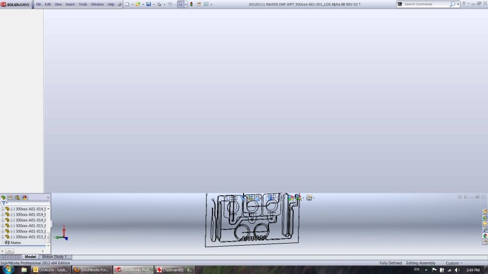

For what ever reason, when I decrease the SW window size and then increase it back to the full screen size, large sections of the user interface become inactive.
The active part is limited to a small section at the bottom of the window.  I discovered this problem when I was trying to work on a external large monitor.  Now i disconnected this external monitor but the problem is still present on the laptop monitor alone.  See the screen shot blow.  The top section is inactive.  The bottom section is maximized and it fills only that narrow strip at the bottom.

Thanks for your help.  Unfortunately using the "Reset to Default" in the Tools-Customize-Toolbars menu does not work.  When I hit the "Reset to Default" I get the message "Do you really want to reset all toolbar customizations to factory default?".  I hit yes and the window blinks several times and the active UI shrinks to a tiny strip at the bottom- as can be seen here (you can see my part as a tiny black dot in the center bottom of the window):
Now when I hit "OK" to the customize window- the UI jumps to it's full window position.  Great.  Everything seems OK at this point.  I restart SW.  And... the problem is still there.  All is well as long as I do not change the SW UI window size.  I can change the specific part window size within the SW window, but if I change the SW window the problem persists.

From the other post.. it looks like the user needed to perform the manual registry edit.  Follow these steps:
Close SolidWorks and open the "Registry Editor" tool by typing "regedit" at a command line prompt.  Try renaming the registry key below or try renaming the "Dock State" registry value found inside the key given below.
    HKEY_CURRENT_USER\Software\SolidWorks\SolidWorks 2012\User Interface\CommandManager
You can rename the registry key as follows... In the left hand portion of the "Registry Editor" program window, perform a right-Mouse click on the "CommandManager" folder shown above and select the "Rename" menu choice from the popup menu.  Change the name by simply appending something to the end, such as "_TEMP" to make it "CommandManager_TEMP".
Now restart SolidWorks and it should recreate the original registry key with default values which should resolve the issue.

Wow.  You made my day.  I can't believe this simple name change actually fixed it.  I won't ask why the hell this all happened, and what on earth does  a registry name change have to do with this.  I am guessing i will not understand the answar anyway.  I just hope this never happens again.
