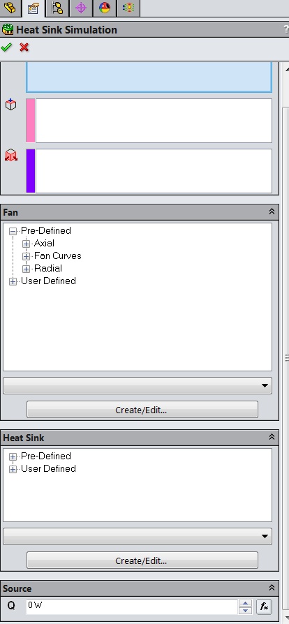

I have a large heat sink 750 mm wide x 350 mm tall x 80 mm fins.  What methoid do I use to enter the known resistance (sink-to-air) and not have to mesh all the fins.  Can I make a simple block and enter a resistance value from sink to air?

tkae a look at porous medium or heat sink simulation

You do not need to be using a fan.
You do not need to know how much power is going where.
It does work with natural convection.
I believe you are right on radiation - they are fluid cells so no surfaces to apply the emmissivity to.
Flow resistance of the sink you calculate using flow sim - sub scale model required.
Thermal resistance you calculate using flow sim - sub scale model.
The general method for use in system level work is attached.

There is no magic button to make the conversion and it isn't as easy as the flow porosity. Also it will not be exact because of some of the things that mark mentions but it will be pretty close. Start with something reasonable that has a known solution and try it.
I think one thing mark is saying above is that you can use a heat sink simulation if you have a fan. For a heat sink only you have to develop the conversion.
