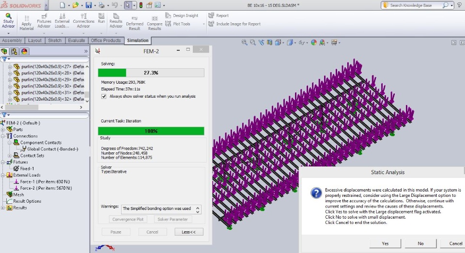

large displacement error in static analysis
hi can any one explain me the solution for this problem ,  i already checked the contacts but every thing looks good but i dont know why it was still showing that my system is not properly restarined. I am using global contact as bonded and also using bonded option for individual components contact. I am attaching the image where u can find the details

SF 2014-06-28 Best Answer
use a gravity load only > if the problem goes away, your load is generating a large displacement
if that doesn't fix it, one or more of your contacts aren't working, you could try a frequency study to see where things aren't connected
this assumes your mateiral properties section properties..etc are all correct
KG
KG 2014-06-30
yes sir i had resolved the problem thankyou very much... the main issue where i have strucked is contacts any way thanks for the solution.
