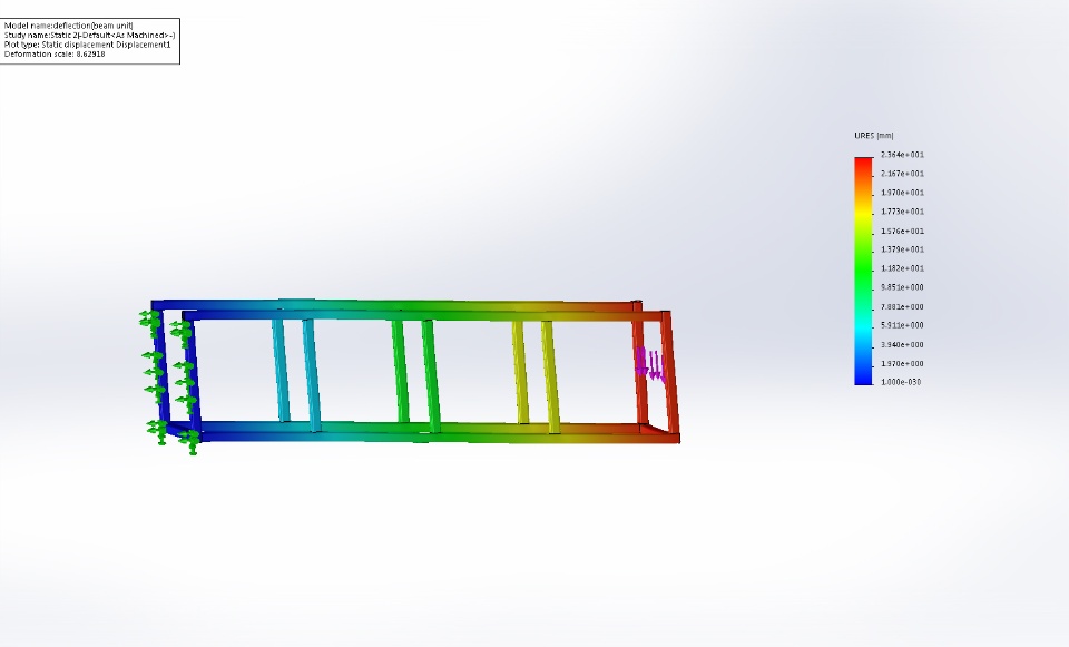

The same geometry model. Two methods are used to calculate the displacement of the structures. The results are so different.
First method with the beam unit:
-The same load:10000N
-Fixture: 4 joints
-Displacement 12.1mm
Second method with the solid unit:
--The same load:10000N
-Fixture: 2 face
-displacement  23.6mm
Who can explain these?
Thanks!
