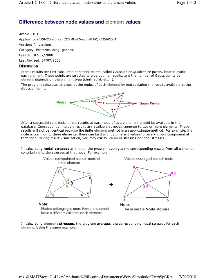

Are element values the average of nodal values or the average of the values at the integration points?  WAY back when in school when we had to write 1D and 2D FEA solvers, problems were solved at the integration points and interpolated to nodal values.  Seems like going another step to element values would be a source of error.
SF
SF 2010-07-29
Hi Jim. you are right. The stresses are calculated at Gaussian integration points inside the element, first thing. Here is the explanation from the COSMOS guys.
SF
SF 2010-07-29
Good pdf, Anthony.  It appears they do go ahead and average nodal results to get element results.  Intuitively, I would think it more appropriate to average the stresses at integration points to get element results, but perhaps there is sound reasoning to do what they do.  This is getting beyond my ever-dwindling knowledge of FEA theory.
SF
SF 2010-07-29
This certainly explains the difference.  Thanks for the information.
