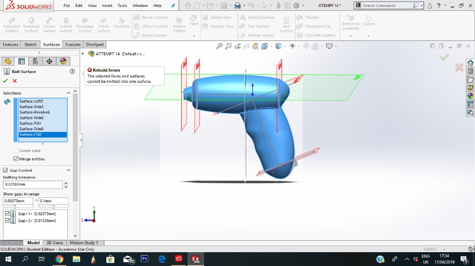

I have been at this drill trying to get it to form one solid body and I am unable to complete the task. Does anyone know how I fix it?
Can you post your model? If not, that error usually indicates that there are 2 surfaces that don't intersect, leaving a gap, or that there is an intersection which will need to be trimmed.
Attach your file please...
Remove the "Gap Control" check and try if not remove the "Merge entities" and try.
