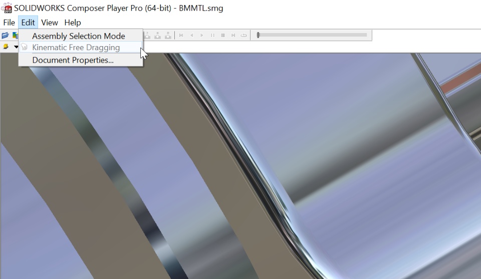

Hi all!
I've a problem with solidworks composer player 2017
Why in solidworks composer player 2017 has this function, but not usable.
I can't effect to tool Kinematic Free Dragging.
Hope everybody help me.
I have attached the description file.
Best regard!

PL 2017-09-12 Best Answer
Hi Bin,
as far as I know, you first have to set up the kinematic function in Composer. Link the parts, set the pivot points
and give them joints with certain degree of freedom. Then export your project to Composer Player and you should be able to use the free dragging tool (if everything is set up correctly!)

Thanks for your suggestion, but I have yet to understand, can you give me a simple tutorial video. Thank you very much!

Here is one video Kinematic Relationships in 3DVIA Composer - Author: Mike Towers - YouTube
Just search in youtube, 3Dvia Composer Kinematic / Solidworks Composer Kinematic / Composer Kinematic.....there are several videos to get you a start.

Thank you for your suggestion. But my idea is that I want to pick up any detail out of the assembler block with the viewer as solidworks composer player, which is like the move part in edrawing. Here I do not need to simulate motion in composer!
My attachment is below.

OK, I don't follow since you asked about kinematics in Composer but are now switching to edrawings. I am glad you found a solution.

My idea that an assembly and want to move the detail in the assembly to any position in the composer player, is there a way to do so, if so please guide me through the video.
