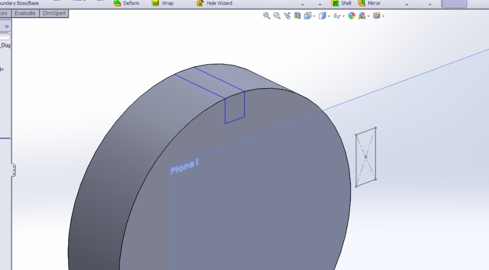

Hello everyone! This is my first post here. I'm basically wanting a sketch to just fold around the edge of the solid shown in the image. Is there a way to get it to project without it wrapping around the top, when it really should only go to about the middle? Thank you guys for your time!

Can you explain your design intent - I suspect there is an easier way to get where you want to go with this.

Basically it's the start of a mud tire with the very large treads that are both on the normal surface of the tire and overlap onto the side of tire, like shown in the photo.

I think Emboss/Deboss or Extrude between the solid and an Offset surface (and then Pattern) might get you there faster.

Forgive my ignorance, but can you give me an example of extruding between a solid and offset surface? I'm not exactly sure what you mean. Thank you for your help!!

You can download similar tyres from Grabcad
Similar SW models available there to download
You can go thru the downloaded model features and see how it is created.
