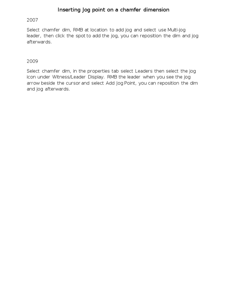

Hi,
How to add a jog point on Chamfer dimension? I tried, but no option found.
Is there any way we can add?

  1. Select Chamfer Dimension.
  2. Right-click  the location at which to add the dimension, and select Use  Multi-jog  Leader.
  3. Click  to place leader jogs, and double-click to place the dimension.
Note: You can drag dimension jogs after setting them

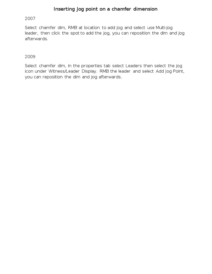

Deepak, FYI see the doc.

Tony thanks for sharing it but for some reason the method you suggested for 2009 doesn't work properly or I might not have used it the right way. Though the method I quoted above works well. Will try again and let you know.

Tried it at work and the add jog point option is not there, I'll try again at home on the laptop again and see, both are 2009.

Just tried it again and got it to work.

Got it working this time , I just need to select the chamfer dimension leader line again to highlight the point and then did the RMB on the leader to add the jog point.
But I can't see the the jog arrow beside the cursor on my machine

Mine shows up when I hover over the arrow line.
